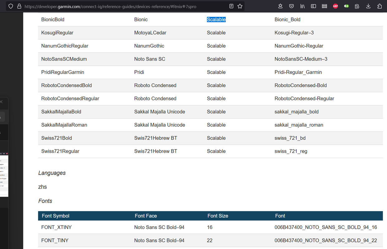

You can also look at the Connect IQ Devices Reference. Optionally click on the device you're interested in, and search for "Scalable".
The left-most column (Font Symbol) contains the face…
The left-most column (Font Symbol) contains the face name to pass in to getVectorFont().
But not all those fonts can be used on all devices with scalable fonts. BionicBold isn't on the Venu3/3s for example. At least per the sim, but from posts I've seen, it's not on the real devices either.
I never said that, did I? The screenshot was simply an example. Next time I'll be sure to type FOR EXAMPLE to make that clear.

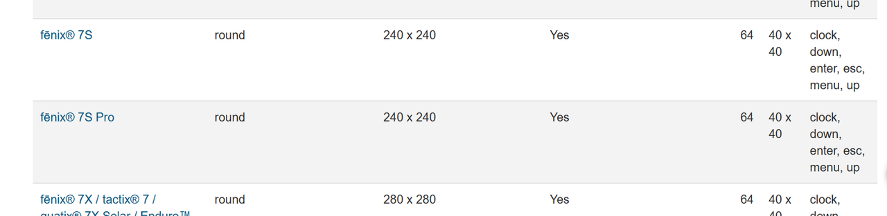

I kind of implied that each device has its own section on the devices reference page when I said "Optionally click on the device you're interested in". I also made sure to include the "#fēnix®7spro" url fragment in my screenshot, but maybe that was a little too subtle.

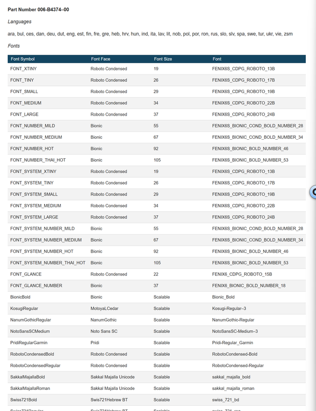

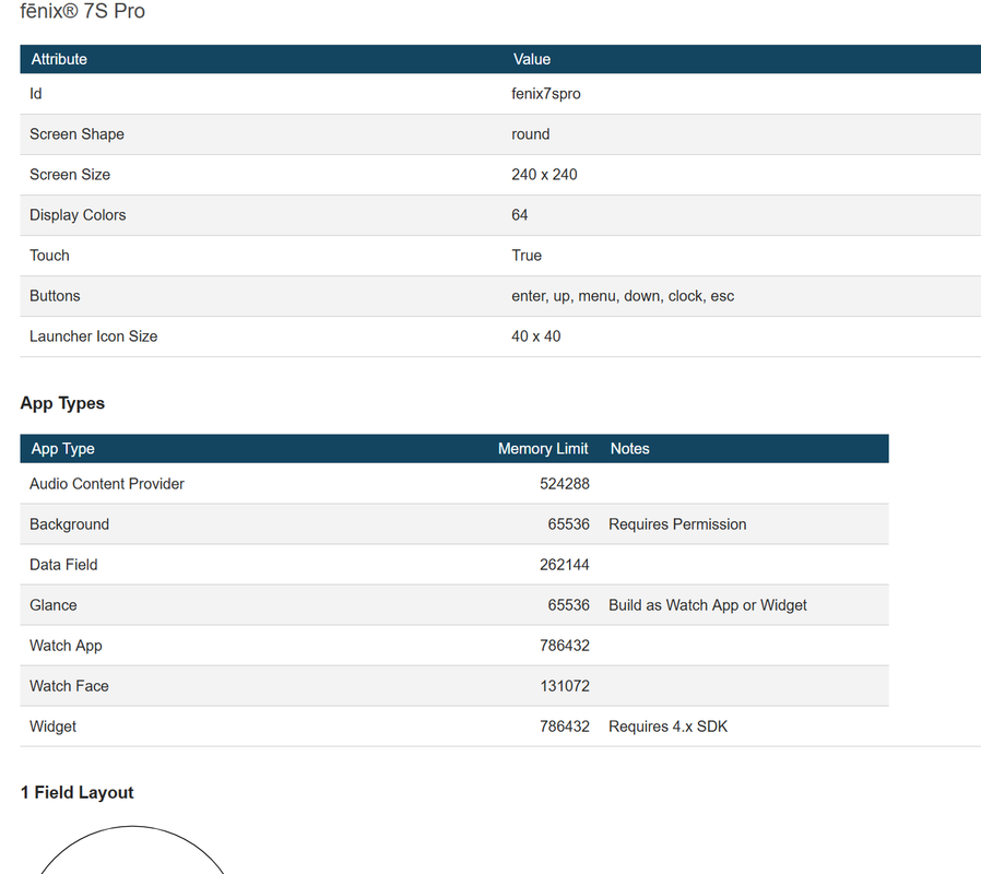

Actually, each device does have its own section, and within each device section, there's a section for each part number (which contains information about available fonts). It's not too different from simulator.json, just in a more human-readable form.

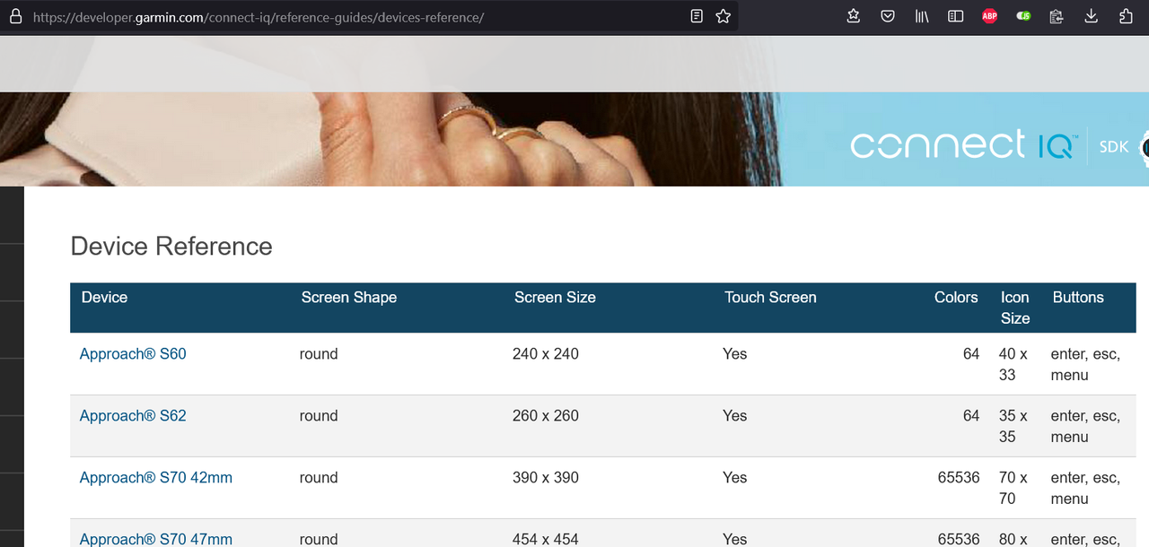

1. Open https://developer.garmin.com/connect-iq/reference-guides/devices-reference/
2. Scroll to Fenix 7S Pro and click on the link
3. Scroll through the Fenix 7S Pro section and note the sub-sections for part numbers, which contain lists of fonts.

So, do I understand it correctly that if the device is on the getVectorFont list, it should have some scalable font supported? Looking at the Approach s70, it has getVectorFont support, but device files and the device reference web page does not seem to contain any scalable fonts ...?
Documentation was probably not updated yet. I see some additional devices on there as well, like FR165.
