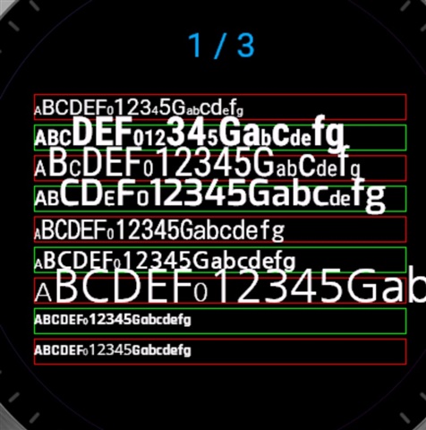

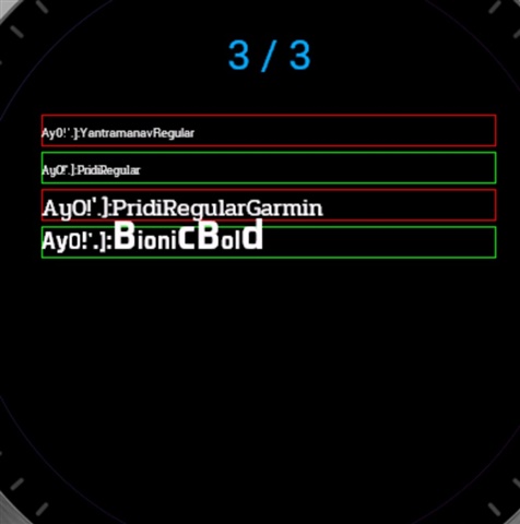

  • Seems the BionicBold font has issues.  Try using another one and see how that works.  I'm pretty much sticking with the Roboto fonts as they are available for all devices with scalable fonts and seem to be working fine.
  • I wrote at test app to see what is going on, both in the sim and the real devices.  In both cases, the font size issues is dependent on the font, not on the device.  So, whatever compensation factor calculation you are doing, it needs to be font-specific, not device specific.
    Unfortunately, the sim's support for scalable fonts is so messed up, it is hard to ensure that an app/WF will look right on all the supported devices.
    Garmin:  Please fix the sim ASAP.  Without this fix, I'm hesitant to publish any apps using scalable fonts since I can't test on all the actual supported devices.

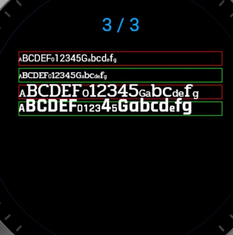

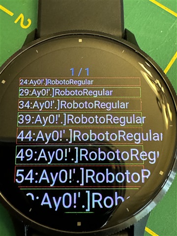

  • Here is the test app on the sim.  I added a bounding box in Garmin's sample app's "Font Mapping" page.
    Code:
        function onUpdate(dc as Dc) as Void {
            dc.setColor(Graphics.COLOR_WHITE, Graphics.COLOR_BLACK);
            dc.clear();
            dc.setPenWidth(1);
            dc.setColor(Graphics.COLOR_WHITE, Graphics.COLOR_TRANSPARENT);
            var inset = dc.getWidth() / 8;
            var cx = inset;
            var cy = dc.getHeight() / 2 - (_maxLinesPerScreen * _fontSize) / 2;
            var just = Graphics.TEXT_JUSTIFY_LEFT;
            var colors = [Graphics.COLOR_RED, Graphics.COLOR_GREEN];
            for (var i = _viewId * _maxLinesPerScreen; i < (_viewId + 1) * _maxLinesPerScreen && i < _fontsArray.size(); ++i) {
                var vectorFont = Graphics.getVectorFont({:face =>_fontsArray[i] , :size => _fontSize});
                var dy = dc.getFontHeight(vectorFont);
                dc.setColor(colors[i%2], Graphics.COLOR_TRANSPARENT);
                dc.drawRectangle(cx, cy, dc.getWidth() - inset*2, dy);
                dc.drawText(cx, cy, vectorFont, "Ay0!'.]:" + _fontsArray[i], just);
                cy += dy + 4;
            dc.setColor(Graphics.COLOR_BLUE, Graphics.COLOR_TRANSPARENT);
            dc.drawText(dc.getWidth()/2, dc.getHeight() / 8, Graphics.FONT_XTINY, (_viewId + 1) + " / " + _viewIdMax, Graphics.TEXT_JUSTIFY_CENTER);

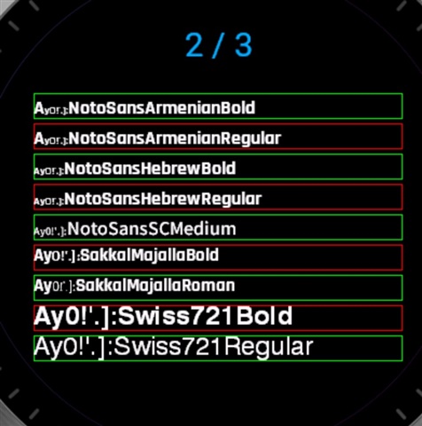

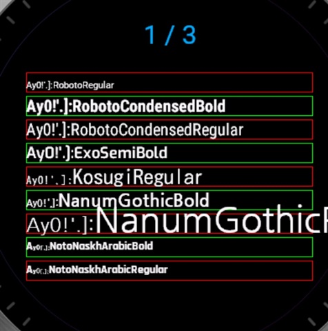

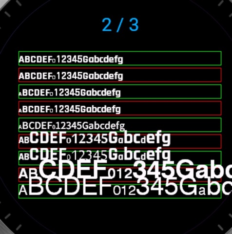

  • Here I've printed a test string in each of the above fonts on the sim.  BionicBold isn't the only one that is seriously amiss!

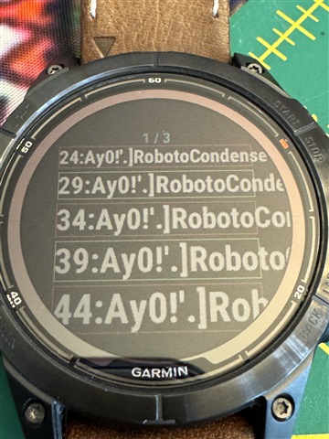

  • Yes, Roboto fonts seems to work best.  Here is the sample app mentioned running on the F7 and Venu3:
