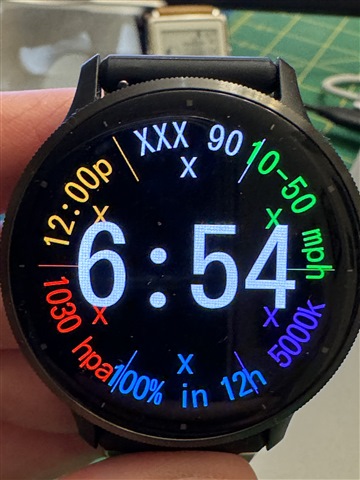

The font returned from Graphics.getVectorFont() is way too large on the F265/F265s/F965/Venu3/Venu3s.
This is what it should look like on all watches:
Venu3:

I wrote at test app to see what is going on, both in the sim and the real devices. In both cases, the font size issues is dependent on the font, not on the device. So, whatever compensation factor calculation you are doing, it needs to be font-specific, not device specific.
Unfortunately, the sim's support for scalable fonts is so messed up, it is hard to ensure that an app/WF will look right on all the supported devices.
Garmin: Please fix the sim ASAP. Without this fix, I'm hesitant to publish any apps using scalable fonts since I can't test on all the actual supported devices.
Here is the test app on the sim. I added a bounding box in Garmin's sample app's "Font Mapping" page.
