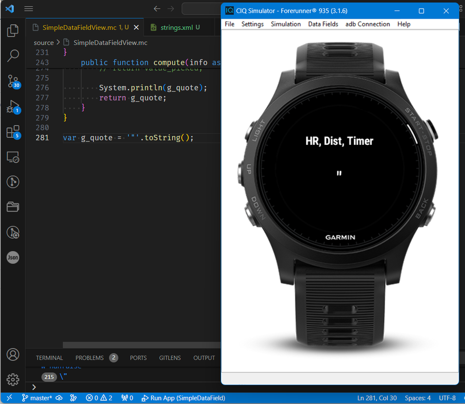

    I can make the same thing happen without even using the "\" character in code, which proves that it's the logger which is adding "\" to quote characters.
    e.g. simple data field:
        public function compute(info as Info) as Numeric or Duration or String or Null {
            System.println(g_quote);
            return g_quote;
    var g_quote = '"'.toString();

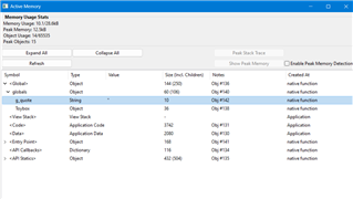

  • Sorry, forgot to post the memory view which shows that g_quote is indeed equal to ".
    This literally prints:
    Note the lack of a \ character in the code. I also don’t think you understand how escaping of special characters generally works in strings if you think the string in your example literally contains a \ character. (Hint: assign that string to a global variable and look at it in the simulator’s memory view. Also, print out the string length.)
