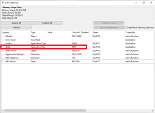

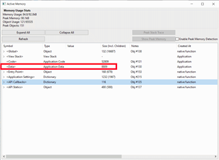

In the simulator, in the Active Memory view, I get different values for "Application Data" when I run the watchface on the same virtual device on each machine.
The SDK (doesn't matter which) is the same as well as all the Monkey C settings (compiler options etc) and the project is synchronised 1:1 via GitHub.
I noticed this a few months ago and with my latest app the difference became significant (~0.6kB).
Also the number in Peak Objects seems to be higher, but I don't know if this is related to that "problem".

Does anyone have any idea why the size of that part is so different and maybe how to even it out?
I've done some tests on my Instinct2 -although they're not represantable- and the overall data size seems to be even smaller than what's shown in the simulator, but it's the same no matter what machine it was compiled on.
