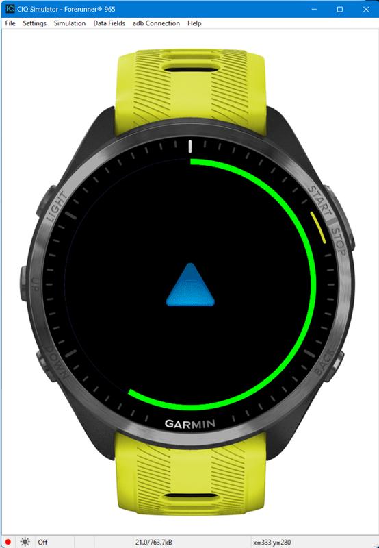

    Example output for fr965 (75% arc):

  • Yeah, what SHN said, except the angle (full arc length) should be 300 (see below).
    Here's another example with a fully customizable drawArcByRatio() function, where everything is an option to the function (instead of using constants.)
    There's a bunch of type warnings (sorry!) but it should compile at the default type check level (-l 1 / gradual)

    Call:
    drawArcByRatio(dc, 0.5, {
        :arcStart => 240, // 270 - 30
        :fullArcLength => 300 // 360 - 30 - 30
    Output:
    Call:
    drawArcBySeconds(dc, 35);
    or
    drawArcByRatio(dc, 35 / 60.0, null);
    Output:
