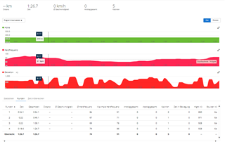

When starting an activity, I see the altitude. But when starting at an altitude of lets say 400m then a boulder hight of 2 to 3 meters is not realy visible in the default views of CIQ web portal. In case of a) and I can manage every single boulder, is there a way of setting my own properties for this?
c) Custom FitContributions
When I work with the session settings from above, custom fitcontribution fields aren't displayed in CIQ web portal. But when I use :sport=>ActivityRecording.SPORT_GENERIC for session settings, they are perfectly shown.

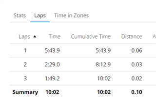

  • I started with the record sample from the 6.4.1 SDK, and added onBack logic to do an addLap.
    Then set the sport to rock climbing, leaving the sub sport empty.
    And in Garmin Connect I see laps on the map, as well as in the summary:
    Adding bouldering as a subsport, I see the laps on the map, but not in the summary
    So the data is in the fit file, just not shown for bouldering
    So if you leave off the subsport, you should be close to what you want
    Here's the two variations:
            //_session = ActivityRecording.createSession({:name=>"rocks", :sport=>Activity.SPORT_ROCK_CLIMBING});
            _session = ActivityRecording.createSession({:name=>"boulder",
                :sport=>Activity.SPORT_ROCK_CLIMBING,
                :subSport=>Activity.SUB_SPORT_BOULDERING
    So your issue is what's shown in GC and not what's recorded on the watch

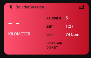

  • You are right and I appreciate your time and effort. The only thing wich is annoying is how the activity looks like in the Garmin app on my android.
  • If I look at the "Phoenix rocks" activity on my Android phone, I see the laps summary data I posted from the GC website.
  • I can see this in my app too. Also my custom fileds are visible. And in the phone app I have it too. The last thing I am not happy with is how the activity is shown as you can see in my last post. 'Kilometer' and 'Geschwindigkeit' (Speed) are nonsense. You think I should ignore it?
