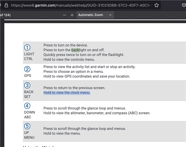

  • The I2 a long press doesn't take you to the watch face
    The Instinct 2 manual suggests otherwise. (I assume "clock menu" is a copy-paste error and they meant to write "clock".)
    Also, the Instinct 2 has hot keys. according to the manual. Is there an implicit assumption here that Instinct 2 doesn't have hot keys (because it's cheaper than Fenix) and any device that doesn't have hot keys doesn't have the "long press Back to return to watchface functionality"? The 2nd assumption might be right, but the 1st seems to be incorrect. Or maybe the manual is wrong. But then again, OP said it works.
    www8.garmin.com/.../Instinct_2_Series_OM_EN-US.pdf

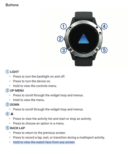

    The Fenix 6 manual says something similar:
    Yes, on some devices (such as 935 and 945 LTE), this functionality doesn't work without explicitly assigning a hotkey, but on others, it may exist even without changing hotkey settings. Yes, I realized you covered this with "the hotkeys may default differently", but based on the manual alone, the default behavior of long-pressing Back should take you to the watch face, regardless of whether you even know about "hot keys" or not.

  • The Instinct 2 manual suggests otherwise. (I assume "clock menu" is a copy-paste error and they meant to write "clock".)
    Actually, on the Instinct 2, if you have a glance full screen, long press of Back take you to a menu with controls.  I just verified that on an I2.
    Yes, it does have hot keys
