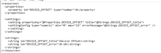

  • I don't have an IMT file. Hmmm. Seems to work fine without the device creating it. Here is one of my User Settings in my properties.xml file. I've always used this pattern and this is the first time I'm running into this issue. See anything I should change? Besides the error range not matching the actual allowable range. I'll fix that.
  • I don't have an IMT file. Hmmm. Seems to work fine without the device creating it. Here is one of my User Settings in my properties.xml file. I've always used this pattern and this is the first time I'm running into this issue. See anything I should change? Besides the error range not matching the actual allowable range. I'll fix that. Which may cause another White Screen of Death.
