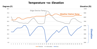

Just back from a weekend riding on the Blue Ridge Parkway. So beautiful. My data field logs Live Weather Temp, Device Temp, and Elevation every 15 minutes so I can plot the graph below. Unlike flat Florida, Device Temp was more realistic, as the temperature varied dramatically as I climbed and descended between 2000 ft and 6000 ft. The general rule of thumb is about 3.5F for every 1000 ft (but that varies of course depending on many factors).

Weather Underground would also suffer from not taking elevation change into account. But Device Temps suffer from sun exposure. Most users won't have a TEMPE sensor. So I'd like to improve on those flaws.
Does any Weather Service report the Station's Elevation? If so, I could at least apply a 3.5F offset as my actual elevation varies from the Station's elevation.
