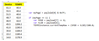

    You must extract the bytes & bits to decode the data. So if you wanted to extract the temperature for example (see 6.4, pg 16), you could do it like this...
    var lsb = payload[6];
    var msb = payload[7];
    // Shift the MSB bits to their correct place
    msb = msb << 8;
    var currentTemp = msb + lsb;
    If you wanted to read the low you also need to mask the bits, eg..
    // 0xF0 = b11110000 Note bit order 7-0.
    var low temp = (payload[4] & 0xF0) << 8 + payload[3];

    Negative Values
    Right now i have the following Problem:
    positive temperatures worked pretty good but right now it is getting colder. And it seems that i have a big Problem with negative temperatures.
    As an example the min Temp code is:
    hidden function minTemp(payload)
    Sys.println( (payload[4] & 0xF0).toString() +"\n" );
    Sys.println( payload[3].toString() +"\n" );
    Sys.println(((payload[4] & 0xF0) << 4 + payload[3]).toString() +"\n" );
    return ((payload[4] & 0xF0) << 4 + payload[3]) / 10f;
    Console output:
    240
    20
    3860
    Return Value is: 386.000000
    The Real Temperature (known from original Garmin Tempe Data Field) is: -23.5
    I dont really get the point how i have to process the Value to get the correct neg value
    3860 --> -235
    does anyone see what i miss?
    Thanks Michael

    It's late and i'm tired. Deleted last message because thought I had missed something. I don't think I had. So yeah...
    I think you need to shift the MSN 8 places. You are only shifting it 4. It needs to move 8 places to clear the LSB.
