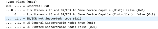

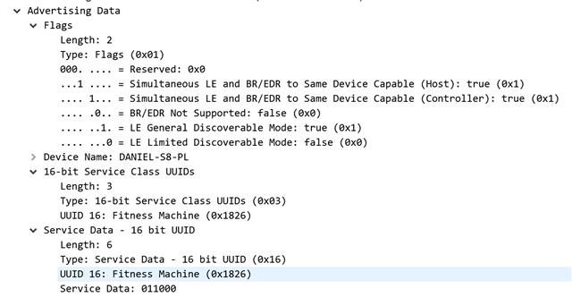

When I compare BLE advertising packets that are seen by a ConnectIQ app and this one, the difference seem to be in the flags.  The working one does not advertise simultaneous connections.
Below is how this advertisement is captured in WireShark.
Any ideas why I can't see this advertisement in ConnectIQ?

    I doubt this has anything to do with the 20 byte truncation, since I see advertising packets that are bigger than 20 bytes in BleScan, and the one I'm interested in, shows as 19 bytes in BleScan.
