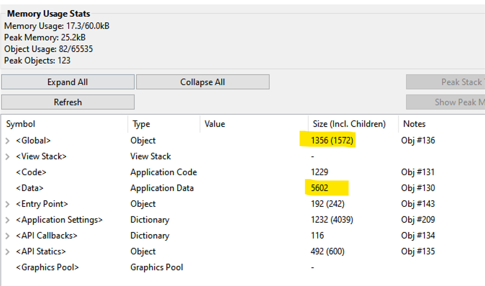

    f6p I haven't updated new devices for f6p (crash due to out of memory) - so it means it's device from 4.1.7
    1. f6p compiled 4.1.7
    2. with 4.2.1 a small differences
    3. 965s with 4.2.1 and the newest device in sim
    the same was when installed new f6p
    I'll build soon new version and will see memory on device, maybe there is a problem with the newest sim or memory viewer.
  • Even the optimizations should be similar between 4.1.7 and 4.2.1 and if any difference the newer compiler should create smaller code
  • But the newer devices have much more memory available so that increase shouldn't be a problem. And still i don't see any problem here, so maybe your jungle file has to be adjusted to know fr965?
    The difference on F6 is strange though. Can you strip down the code to some example to be able to post to the forum so we can also investigate?
  • First I'll check difference between memory on real device between 4.1.7 and 4.2.1.
