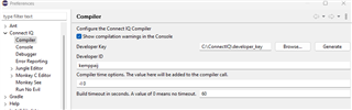

  • or anybody else solved this wit Eclipse
    Is it possible to somehow remove typechecking in Eclipse, because otherwise I'm stuck with SDK 4.1.5
    This will not work:
    Also project.typecheck = 0
    No luck with this either, I got some weird errors and don't know how to overcome them.
    Like for this
    // Load your resources here
    function onLayout(dc as Dc) as Void {
    Cannot resolve type 'Dc'.
  • Actually this seems to work now yeiii!
    false alarm
