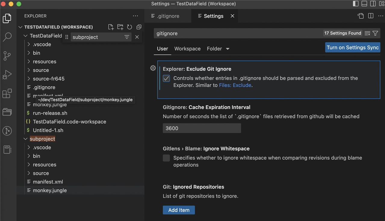

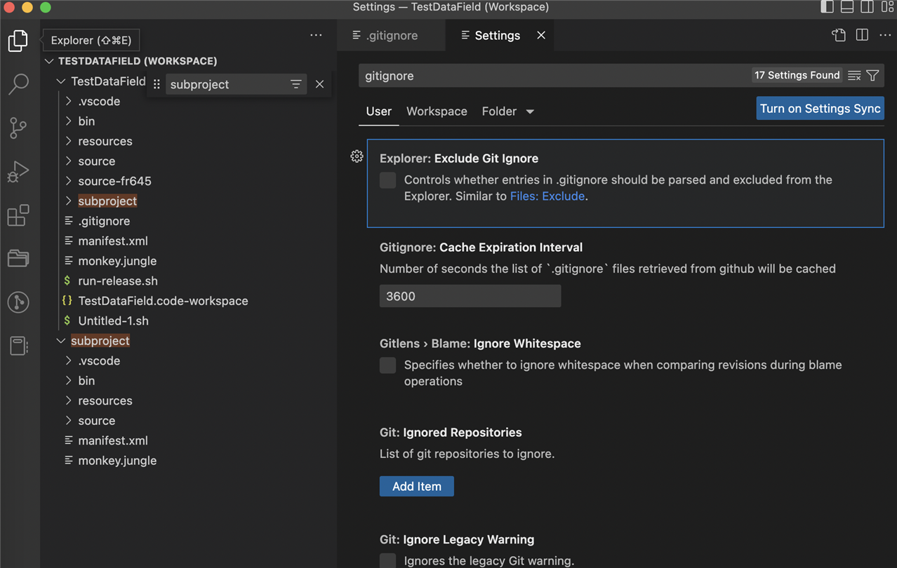

  • If you have your heart set on preserving the existing folder structure (I totally get this btw), I found that you can actually have one project exist as a subfolder of another project in VS Code (for some reason I assumed this was impossible but I should've known better since it works fine for git subprojects.)
    So you do everything I suggested, except moving existing items to the basic/ subfolder.
    myAwesomeProject/
    ----source/
    ----resources/
    ----monkey.jungle
    ----manifest.xml
    ----advanced/
    |   ----source/ -> ../source/
    |   ----resources/ -> ../resources/
    |   ----monkey.jungle
    |   ----manifest.xml
    You can even add a .gitignore to myAwesomeProject/ with the following contents
    advanced/
    Then open User Settings and enable Exclude Git Ignore
    This will hide the advanced/ folder from your top-level myAwesomeProject explorer tree (so you don't have to see it twice.)
    e.g.
