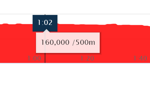

  • Thanks for the beta app suggestion!  So now I have a specific question Slight smile
    What do I write in the FIT file record so that Garmin Connect displays the data below in m:ss / 500m?  E.g. below should be displayed as 2:40/500m.
    For what it's worth, TrainingPeaks is much closer to what I want to see.  TP shows the same format as a native Garmin Indoor Rowing app.
    This is exactly the same FIT file that gets exported to TP automatically from GC.
  • I don't understand what are the numbers on the 1st image. 1;02 is 1 minutes and 2cseconds into the excersize? And what is 160000? Is that milliseconds? Shouldn't it be something like 125 sec/500m which would be the equivalent of 2:05/500m?
    What are the values and the unit you currently write to that fit field?
