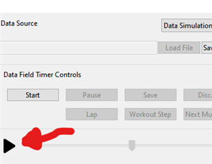

  • on sim you have press play and  hr/body batterry spo2 won't null (but most of them shortly max and const, spo2 100, HR 162....)
    import Toybox.Activity;
    var _actInfo = Activity.getActivityInfo();
    var hr = _actInfo ? _actInfo.currentHeartRate : null;
    //hr can be null of course...
