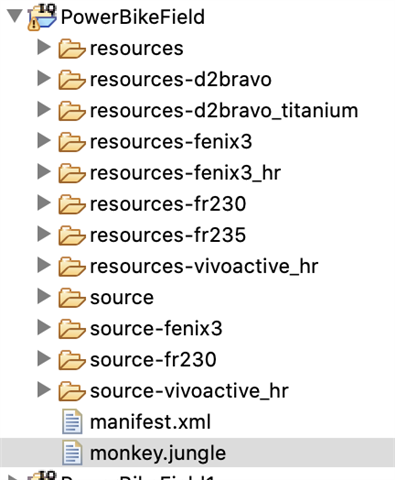

  • I think my jungle are too old can you give me an example of new jungle files
    I got this on jungle but it's not working with 4.1.7
    project.manifest = manifest.xml
    srcBase=source
    resBase=resources
    base.sourcePath = $source(srcBase)
    base.resourcePath = $resource(resBase)
    base.excludeAnnotations = source-fenix3
    base.excludeAnnotations = source-fr230
    base.excludeAnnotations = source-vivoactive_hr
    vivoactive_hr.sourcePath = $(vivoactive_hr.sourcePath);source-vivoactive_hr
    vivoactive_hr.resourcePath = $(vivoactive_hr.resourcePath);resources-vivoactive_hr
    vivoactive_hr.excludeAnnotations = source
    my directories are this
