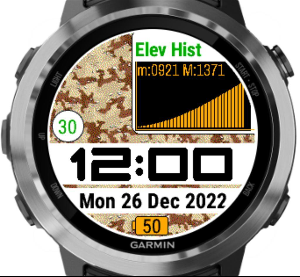

    i did the homework, i find the history length first and then show the data into graphs. Looks like working like a charm. I must say that i didnt carefully read the documentation... your example is better than the one into doc!
    thank you very much. My watchface is almost ready... (camuflage watchface)
