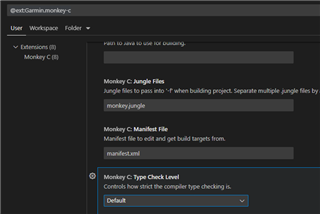

but when I click Run this is the command I see in the terminal:
java -Xms1g -Dfile.encoding=UTF-8 -Dapple.awt.UIElement=true -jar /home/gavriel/Garmin/ConnectIQ/Sdks/connectiq-sdk-lin-4.1.6-2022-11-04-17f8cfdf3/bin/monkeybrains.jar -o bin/MyApp.prg -f /home/gavriel/Garmin/MyApp/monkey.jungle;/home/gavriel/Garmin/MyApp/barrels.jungle -y /home/gavriel/Garmin/developer_key.der -d fenix6_sim -w -l 3
WARNING: The type check level is specified both at the command line and in a Jungle file. The Jungle file specification will be ignored.
And why the setting in the plugin settings override the setting in the jungle file?
