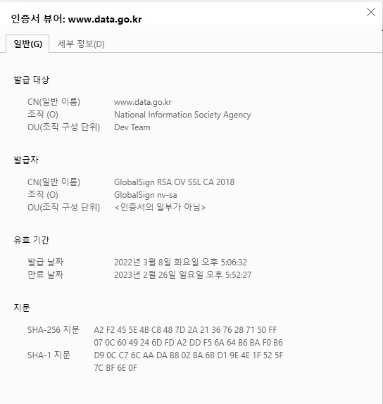

I looked for similar cases as mine and found out there may be HTTP/HTTPS issue, or HTTPS with self-signed cetificate issue.
But I think those issues are not applicable to my case. (I'm using HTTPS with not self-signed certificate)
How can I get through?

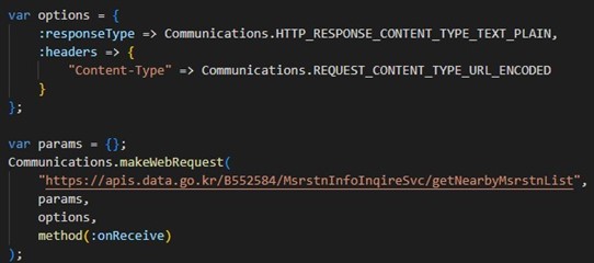

I also attach source code below, but I think there's nothing to do with code itself(too simple to work on it)
