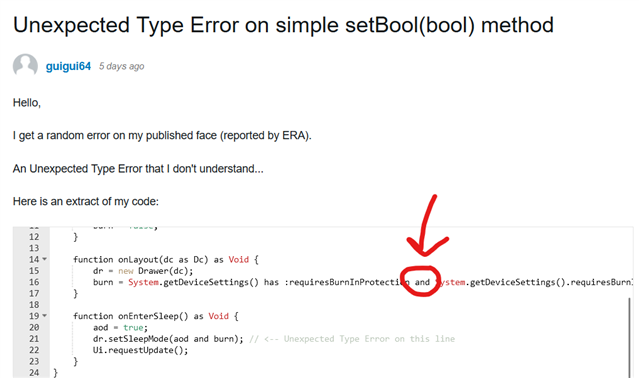

Unexpected Type Error on simple setBool(bool) method
Hello,
I get a random error on my published face (reported by ERA).
An Unexpected Type Error that I don't understand...
Here is an extract of my code:
// View.mc
class View extends Ui.WatchFace {
    private var burn as Boolean;
    private var aod as Boolean;
    private var dr as Drawer;
    function initialize() {
        WatchFace.initialize();
        aod = false;
        burn = false;
    function onLayout(dc as Dc) as Void {
        dr = new Drawer(dc);
        burn = System.getDeviceSettings() has :requiresBurnInProtection and System.getDeviceSettings().requiresBurnInProtection;
    function onEnterSleep() as Void {
        aod = true;
        dr.setSleepMode(aod and burn); // <-- Unexpected Type Error on this line
        Ui.requestUpdate();
// Drawer.mc
class Drawer {
    private var _dc as Dc;
    private var _sleepMode as Boolean;
    function initialize(dc as Dc) {
        _dc = dc;
        _sleepMode = false;
    function setSleepMode(sleepMode as Boolean) as Void {
        _sleepMode = sleepMode;
Can you see what is going on? Could the variable burn become null at some point?

  • Why are you using “and” as a variable name?
    I strongly suspect that confusion with “and” in your code is really not helpful… try renaming it to something better and then using conventional operators in your logic.

  • 1. Why do you set dc to member?
    2. Use && instead of and maybe there is a bug.
    3. there is no all code so show onExitSleep and onShow though

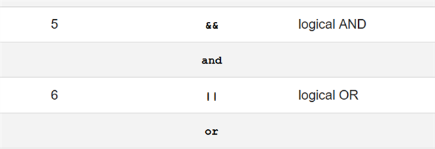

  • Yes use && (it's different than just &).  Maybe onUpdate and not onShow,  That's where you'd do things differently if in low power or not.
  • 2. Use && instead of and maybe there is a bug.
    OP is using "and", not "&".
    According to the CIQ docs, "&&" and "and" are synonymous, or at least they should be.
    developer.garmin.com/.../

    Comes across as a little condescending imo, since nobody mentioned "&" anywhere and "&&" was already suggested. Will you also remind everyone that "==" and "=" are not the same any time either of those operators are mentioned?
