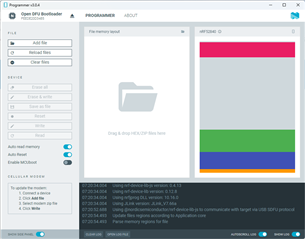

I believe flashing the NRF dongle went fine, COM port also seems correct:
Any ideas? Thanks a lot!

  • You are using nRDConnect for Desktop, correct?  Windows or mac? Updating to 3.12.0 on win 11 right now.  (It's been a few years since I flashed) and updating the programmer to 3.0.4

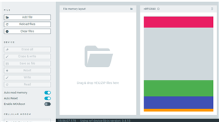

    The dongle I'm using was already flashed, but here is what I see:

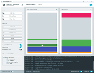

    When I drag in the hex file, this:
    After flashing, I do see this:
    07:24:12.693
    Failed to write: Error: Timeout while waiting for device FEEDE20D3485 to be attached and enumerated
    So I programed the dongle with the Bluetooth low energy app (using nRF deskop), and verified that it didn't work with CIQ, then programmed the hex file that works with CIQ.  with unplugging and replugging after each step. I moved from com5 to com7, and it's working with com7 in the sim.
