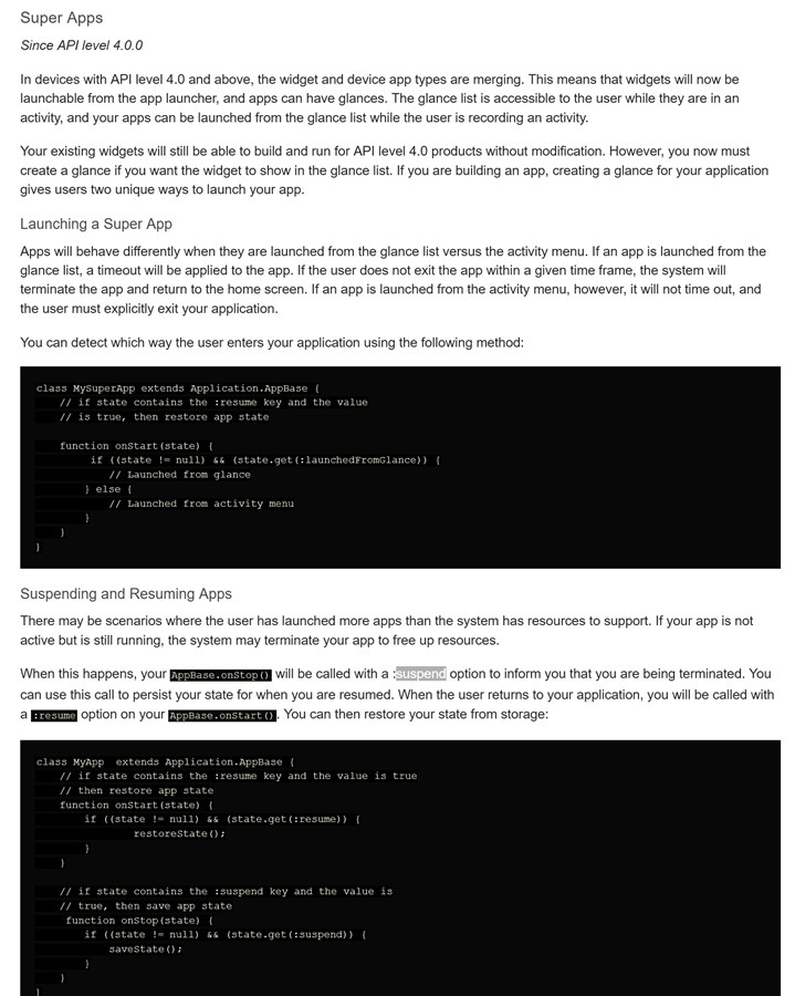

    EDIT: actually it seems that :resume is all about suspended super apps, and has nothing to do with "Resume Later" for data fields.
  • I have wondered several times what does this mean :suspend /:resume. Does it apply to all types of applications or just the date filed? It is understandable in case of DF but other types?
  • Hmmm perhaps suspend/resume has nothing to do with "Resume Later", but is in fact all about super apps.
    https://developer.garmin.com/connect-iq/core-topics/application-and-system-modules/

  • And it means state is only for new type of apps named superapp (there is no such type in eclipse). And this superapp has the same like in older one, view and glance.
    I don't have 4.0 watch. I do not understand what does it mean? No separate view for widgets? Everything is mixed in one place applications / widgets / activities?
    It's just a CIQ thing which means that there's no more CIQ widget app type for CIQ 4 devices. Basically, one super app can provide both "device app" and "widget" functionality. The device app part is mandatory, and the widget part is optional.
    In the UI, widgets and apps still exist; widgets still go in the "glance list / widget carousel" (accessed by pressing UP/DOWN from the watch face), and apps still go in the activity list (accessed by pressing START from the watch face).
    However, it's now a single CIQ app which provides both kinds of functionality. By default, a device app goes in the activity list (just like before). If you *also* want the app to go in the widget list, you provide a glance view.
    Notes:
    - I don't think "super app" is supposed to literally be a separate type. If you create a device app for a CIQ 4 devices, it's automatically a "super app". You just have the option to provide a glance view and it also becomes a "glance/widget."
    - in the UI for newer devices, widgets are exclusively referred to as "glances" now
    - if you launch a CIQ super app from the glance list, it will still time out after a certain period of inactivity, just like widgets in the past
    - for CIQ super apps, every CIQ glance will also be in the activity list, but not vice versa. I don't think there's any way to have a CIQ 4 app that's in the glance list, but not the app/activity list.
    - native glances are *not* also in the activity list (as far as I know), so this highlights how this is really just a CIQ thing (IMO)
    EDIT: based on what Jim posted, it seems that either a device app or a widget can be a super app in CIQ 4.
  • If you take a widget with a glance and build it for a CIQ 4.x device, it because a "Super App" - A device app with a glance.
    Widgets are not supported on CIQ 4 devices, and if you build one for a CIQ 3 device and sideload it to a CIQ 4 device, it won't run and you'll see a message in the CIQ Log file.
    If you take a widget type app, build it for a CIQ 4 device, it will show in both the glance loop as well as the list of activities, (no glance there) because it's really a device app..
