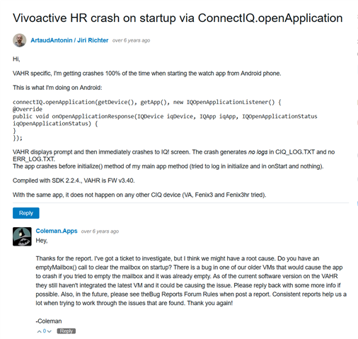

  • For what it's worth, people have been using and talking about  connectIQ.openApplication() for over 6 years. A Garmin employee responded to a bug report about it, and didn't tell the dev not to use it or that it was unstable/unsupported.
    6 years seems like a long time to leave a work-in-progress function in the API without either finalizing it or removing it.
    https://forums.garmin.com/developer/connect-iq/f/discussion/237001/mobile-sdk-openapplication-behaviour-in-ciq-3-2-just-this-once-always-no
    https://forums.garmin.com/developer/connect-iq/f/discussion/4620/vivoactive-hr-crash-on-startup-via-connectiq-openapplication
