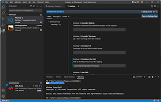

  • -y is for your developer key  It looks like you don't have it set correctly.  Here's where you do that
  • Thanks!!
    It is set in the workspace settings. If I set it in de user settings I get another error:
    When I open settings, I see a JSON file with:
        "php.validate.executablePath": "C:\Users\Gebruikers\.................\Bureaublad\PHP Execution"
  • This one has been solved... but now I get another error:

  • Looks like the compiler can't open your key file:
    ERROR: C:\Users\Gebruiker\Dropbox\Programmeren\Monkey C (Access denied)
    java.io.FileNotFoundException: C:\Users\Gebruiker\Dropbox\Programmeren\Monkey C (Access denied)
    '-y', 'C:\Users\Gebruiker\Dropbox\Programmeren\Monkey C'
    It seems that you've set your developer key path to:
    "C:\Users\Gebruiker\Dropbox\Programmeren\Monkey C"
    Is this a folder or a file? It needs to be the full path (including filename) to the key file that you generated with:
    CTRL-SHIFT-P > Monkey C: Generate a Developer Key
    If the path is set correctly, try placing the key outside of your dropbox, in case dropbox is somehow preventing access to the key.
  • This was the trick... thank you so much.
    I assumed that the path was without the filename, as it is with the Java path.
    No all works! Thanks!
