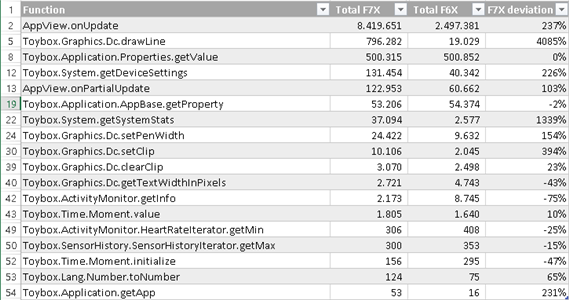

Here the result of the Profiler for my watch face running 5 minutes of profiling for both devices F7X <-> F6X
If the results are really representing the hardware speed of the real devices then Garmin will have a lot to do to speed up the new device generation.
Main result of the onUpdate logic speed -> the F7X rendering is more then three times slower then the F6X
F7X to F6X simulation speed
Feel free to discuss the differences of the SDK Toybox function speeds for each device. This is really interesting.
  • Results on the F7X simulation on Toybox function calls ->
    DC.drawLine - extremely slow
    System.getSystemStats - extremely slow
    System.getDeviceSettings - very slow
    Dc.setClip - very slow
    Dc.getTextWidthInPixels - a lot faster!
    ActivityMonitor iterators - faster
    SensorHistory - faster
