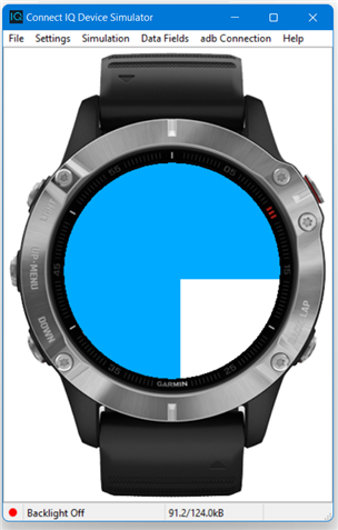

Now when I leave out the width/height it doesn't complain but I can't seem to get anything on the screen. I paint the whole screen blue and than I want the layer to be white and be painted.. yet my screen stays all blue.

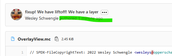

Full code can be found here: gitlab.com/.../OverlayView.mc

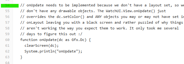

  • I'm still a bit baffled tho. Why does it DO paint the dc for the view with clearScreen() in onLayout(), but it doesn't do anything for the layer. Yet, when we move the whole shebang to onUpdate() it works. They both have access to the dc object, they both call the same code, one would expect the exact same result..
    Great question. I will just make another wild guess (since those always turn out so well >_>) that onLayout() is called too early to do any layout rendering, although drawing stuff on the (main) dc works at that point.
    It's a moot point since, as discussed, you need to render everything in onUpdate(), so there's basically no point in drawing anything in onLayout.

    Kind of interesting that you don't need to call View.onUpdate() though. It would work if you called it *first* (and that would be necessary if you had a layout and you also wanted to do other stuff programmatically.)
    e.g. typically in onUpdate, you would:
    1) Clear the screen (literally just clearing the screen in this case)
    2) call View.onUpdate()
    3) render other stuff

  • I'm not 100% agreeing with you. onLayout is when the view first get's displayed on the screen. So it is actually a thing of beauty because you know when you are in there your whole View is in a blank state. You don't need to keep track of counters, etc. You just paint your initial picture and be done with it.
    But I'll just accept that onLayout is the actual constructor and shouldn't do any painting what so ever and just deal with that in onUpdate().
    Yeah I was just describing how things are, not how I think they should be.
    Some people have tried to get away with not rendering *everything* in onUpdate(), and it comes back to bite them because of notifications and other issues (I think view slide animations have a similar issue - if you don't clear the screen after an animation, then part of the animation might linger on the screen.)
