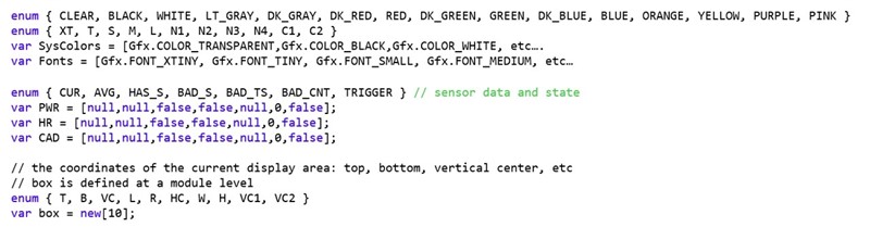

It has some problem with a container, so probably with the PWR / SysColors / box / Fonts arrays. Can you post their declaration so we can see their type?
Thanks. See anything here? SysColors and Fonts are global. box is at the module level. Maybe the PWR array because it uses multiple types? This works without warning in until the beta compiler.
None of your arrays are typed, it might be the issue. I would add types:
var SysColors as Array<Graphics.ColorType> = [...] as Array<Graphics.ColorType>;
etc...
For existing apps, I would simply turn off type checking (-l0) as it's going to be more than a simple change to use type checking, especially if you have a bunch of apps.
If you have a mature and established app, I don't think adding type checking does much for you except cluttering up the code.

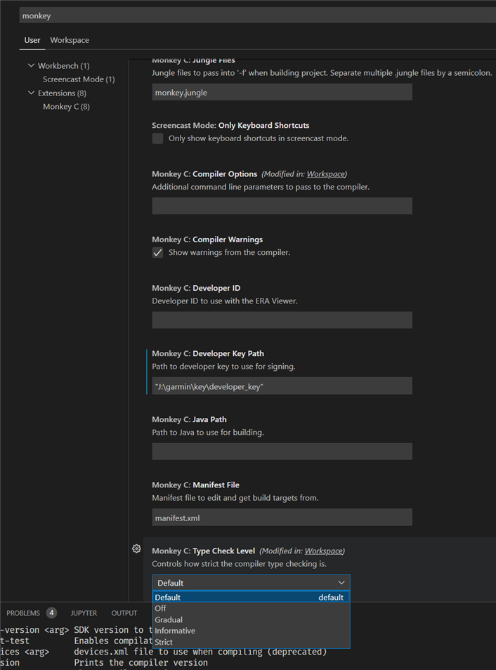

Note that compiler options are case-sensitive, and the option for changing the type-checking level is -l (lowercase L), not -L.
You can see a full list of compiler options by passing in the -h option.
Also, you can set the type-check level using an option in the VS Code Monkey C user/workspace settings (no need to set the command line option manually):
