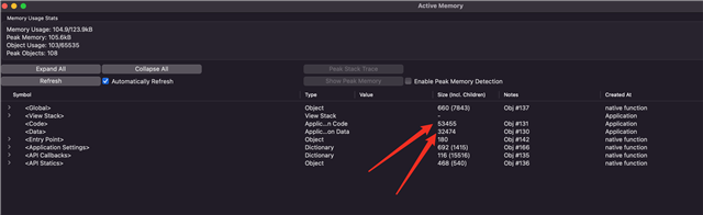

I'm trying to add support for Instinct to the meditate app. It builds fine with the latest 4.1.1 SDK but crashes immediately with OOM (out of memory) when launching against a simulator.
Launching it against a different target (Fenix6) indicates that the app peaks at 106kb which is somewhat more than 92kb that are available on instinct2 (as far as I understand).
How would you go about reducing the memory foot print?

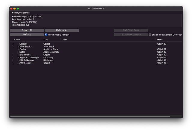

Anyway TLDR:
1. App at peak is 106kb
2. I remove 28kb worth of stuff.
3. App at peak is 96kb now.
How would you suggest I go about reducing the app size so it works on Instincts?
