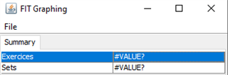

The session is saved successfully and heart rate and duration is fine (on my real device) but the custom data does not show up anywhere.
When trying to debug this with monkey graph, I don't see anything at all though like following:
Any ideas what I'm doing wrong here?
