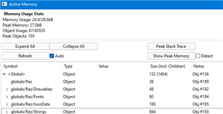

    Just to prove my point, I modded a data field app of mine which has a bunch of resources and changed it so it just loads one JSON resource and exits. Look at how much memory is wasted by string IDs - and my app only uses strings for settings.
    But why take my word for it? Just try it for yourself.

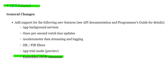

  • How do you know that jsonData is supported from CIQ 2.3? I don't see any mention of that in https://developer.garmin.com/connect-iq/core-topics/resources/ or in the documentation: developer.garmin.com/.../WatchUi.html
  • I seemed to remember it being a compiler error message, but maybe I saw it in the docs somewhere. But yes jsondata as a resource isn't supported in CIQ 1. I use / parse strings to get the same effect.
    The JsonDataResources SDK sample specifies minSdkVersion as 2.3.0. If you try to build a project containing JSON resources for an unsupported device, the compiler will spit out an error message such as:
    JSON resources are not supported by device 'fr235'.
    I wish stuff like this was explictly documented, too, but apparently Garmin prefers folk knowledge to be continuously rediscovered by trial and error, or propagated through the forums. I also think Garmin doesn't care too much about older devices.
