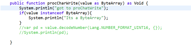

I have managed to write a program that connects to my power meter via Bluetooth, I have set up a profile for the power data and retrieved it via BLE. When I try and decode the output I get the following error:
"Details: Could not find symbol 'decodeNumber'"
I imagine this means that the value I am getting in my power characteristic is not a ByteArray but an Object, I am unsure how to get the data I need from this if that is the case. Here is my profile manager code:

if (_powerMeterData instanceof Toybox.Lang.ByteArray){
System.println("yup");
value.decodeNumber(Lang.NUMBER_FORMAT_UINT8, {});
var pd = _powerMeterData.decodeNumber(Lang.NUMBER_FORMAT_UINT16, {});
System.println(pd);
System.println(_powerMeterData.toString());

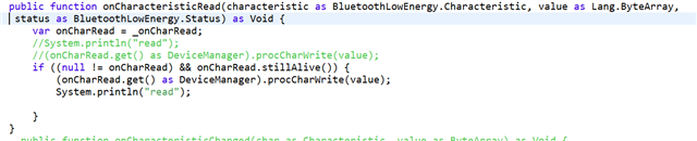

    public function onCharacteristicRead(char as BluetoothLowEnergy.Characteristic,status as BluetoothLowEnergy.Status,
    value as Lang.ByteArray) as Void {
     setUpModel();
    if ((null != _onCharRead) && _onCharRead.stillAlive()) {
    (_onCharRead.get() as PowerMeterBLEModel).onCharacteristicRead(char, value);
    However, when I run it I get the following error:
    Error: Symbol Not Found Error
    Details: Could not find symbol 'onCharacteristicRead'
    Stack:
    - onCharacteristicRead() at C:\Users\PC-User\eclipse-workspace\PowerMeterBLE\source\PowerMeterBLEDelegate.mc:75 0x1000035c
    There definitely is an onCharacteristicRead() in PowerMeterEnviromentModel and it is instantiated so I don't really know what's going on.
    System.println("not alive");
    System.println(_onCharRead);
    setUpModel();
    System.println("Read called in delegate");
    //dataModel.processPowerValue(value);

    public function notifyCharRead(manager as DeviceManager) as Void {
    System.println("Notify Char Read");
    _onCharRead = manager.weak();
    // public function notifyCharChanged(manager as DeviceManager) as Void {
    // System.println("CharChanged");
    // _onCharChanged = manager.weak();
    //! Broadcast a new scan result
    //! @param scanResult The new scan result
    private function broadcastScanResult(scanResult as ScanResult) as Void {
    System.println("broadcast");
    var onScanResult = _onScanResult;
    if (onScanResult != null) {
    if (onScanResult.stillAlive()) {
    (onScanResult.get() as DeviceManager).procScanResult(scanResult);
    //! Get whether the iterator contains a specific uuid
    //! @param iter Iterator of uuid objects
    //! @param obj Uuid to search for
    //! @return true if object found, false otherwise
    private function contains(iter as Iterator, obj as Uuid) as Boolean {
    for (var uuid = iter.next(); uuid != null; uuid = iter.next()) {
    if (uuid.equals(obj)) {
    return true;
    return false;
