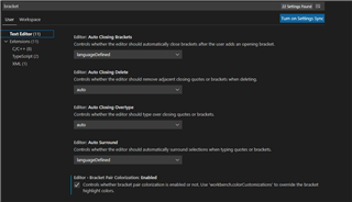

    Fair enough. The setting is also available in the regular settings interface:
    I think if you start using VS Code for complex projects (including non-Monkey C stuff), it would be helpful to use the native feature to avoid performance issues. I've def seen the problem where Bracket Pair Colorizer 2 just stops working, when I have a ton of files open (not sure if it's also related to having multiple VS Code windows open). In this case the only way to fix it is to restart VS Code. I'm hoping this won't happen with the native feature.
