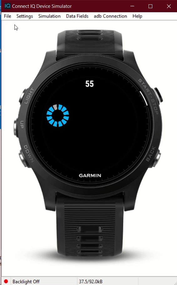

  • It works for me, exactly as I described.
    The only substantial change I made to your code (other than changing colors) is to divide by 5.0 instead of 5.
    Every state lasts for 5 seconds, except:
    - No segments (only when secs is 0)
    - All segments (only when secs is 56-59)
    If you think about it, the discrepancy here is because you have 13 states instead of 12, and it's really not consistently defined what it means for a segment to be full. (If it was consistent, you'd either never see all segments full or you'd never see no segments full).

    Here it is at 4X speedup:
    Original video:
