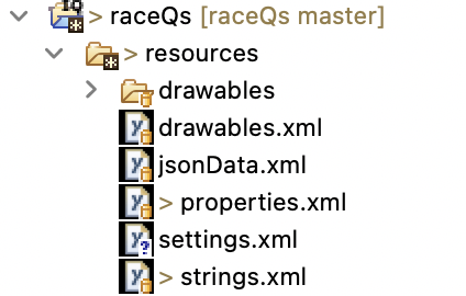

    Where is your settings XML located?
    I've tried a few options:
    a)initially in a separate settings.xml:
    b)Then I included them in the properties.xml, encapsulated in a <resources> tab - that was what got it working.
    I have tried relocating to a) and b)with no success.
    BTW, I get confused with the terminology:
    are settings AppBase.data or Storage.data?
    Here's my current properties.xml:

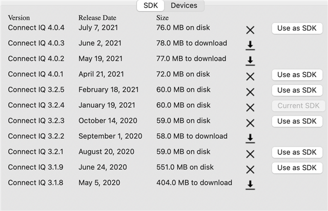

  • Here's an interesting result.
    when I change SDX to 3.2.4, the settings appear.
    And when I change back to 4.0.4 Which is where I was when it was failing) they also appear.
    Curioser and curiouser!

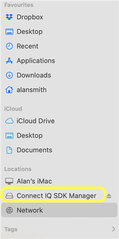

    There's something off about the new SDK which is getting installed as a file system in my /Volumes folder.
    Previous SDKs were running from my downloads folder.
    Still it's back working co I can return to my project work (after 2 days in limbo).

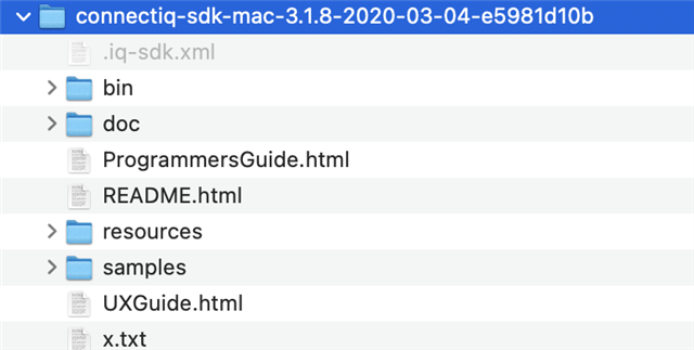

    BTW in the previous SDK, the samples were packaged with the SDK.
    I don't see any samples in the SDK 4 package.

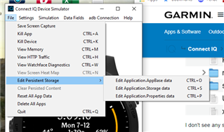

    As I mentioned originally, you edit app settings in simulator by selecting Edit Application.Properties data. I'm not sure why you don't have that option in the simulator. Testing this briefly in Windows, I see this option whether or not the currently running app has properties/settings. My simulator version is 4.0.4.
    In Eclipse, try selecting Connect IQ (from the menu) > Samples, when Connect IQ 4.x is your selected SDK.

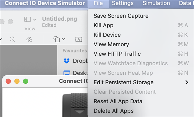

  • As I mentioned originally, you edit app settings in simulator by selecting Edit Application.Properties data. I'm not sure why you don't have that option in the simulator.
    Nope, not there:
    OK, found it... old dogs...new tricks, thanks.

  • Nope, not there:
    I meant (as I said originally):
    File > Edit Persistent Storage > Edit Application.Properties Data
    I see from your other screenshot that you don't have it in any case. I have no idea why that's the case but it shouldn't be a problem for you since you can use the app settings editor.
  • It wont be in the sim with an older SDK.  If I recall, app setting in the sim first came out with the 4.0.3 SDK.
    The OP says:
    "Mac, Eclipse, SDK 4.0.4"
    And they posted the following screenshot (presumably before they switched back to an older SDK):
  • Even if the app doesn't have app settings (this WF uses on device settings), I see the option.
    Maybe the 4.0.0 SDK is being used, but maybe the sim is an older version and wasn't restarted after switching SDKs.
    Help>About in the sim will show the version of the sim that's running.  You also want to be running the 4.0.4 Eclipse Plugin.
    If I click on Edit Application.Properties, I get this:
    Which is true in this case.
