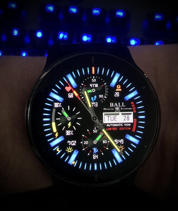

if you wanna the best results, I think the tilemapper tool is the one to go with - considering backwords compatibility. The new framework will now support image rotation with some promising results, but works only on new devices. The tilemapper tool is the best to go with, it takes up some space and memory, but you get pretty much what you wanna. I have tried to focus on good sharp graphics on my watchfaces, but it's not an easy task. A lot of graphics, antialiasing not supported on old devices etc etc... so kind of a limbo, but there is good ones also in the CIQ. Tilemapper used on the hands…This one is coming soon, with complications
