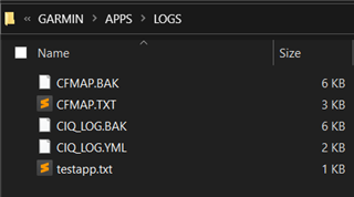

I'm having some trouble with a single user of my app who has a 935.  The app will not write to the debug log, but I cannot figure out why (and I have a problem I need to debug).
The Log is in APPS/LOGS/<APPNAME_SAMECASE>.TXT and the app is in /APPS/<APPNAME_SAMECASE>.prg
This works fine on my Vivoactive 3 when I build exactly the same code and deploy it.  I get plenty of logs.
I ran a Zoom session to eyeball what he's doing, and unless we're both blind it's exactly the same name TXT file to the app name, but it never changes from 0 bytes.

  • There is something odd with your code, as I know I've used debug logging on many devices from CIQ 1 to CIQ 3 with no problem.  Including things like the fenix 5 which is really the same as a 935 CIQ/FW wise,
