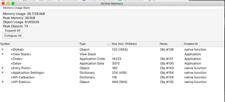

I have developed a data field and I am really on the memory limit for some of the devices. Basically as soon as I add any more code/functionality to the data field I get "out of memory" in the sim (even one line of code may tip it over). I understand that memory available for data fields is restricted and the only way forward for me is to optimize memory usage of my data field.
On the Phoenix 5 Sim, I get peak usage 28.5kB, so clearly hitting the memory limit, but when I bring up the memory usage stats in the sim, the memory size does not add up to the 28.5kB. I'm using a background process, could it be that the memory used in background is not shown here?
