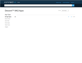

I am unable to preview the applications after page 4. All pages from page 5 onwards are displayed as blank. This applies to any of the application sections and any sorting
https://apps.garmin.com/en-US/devices/descentmk2/apps?start=120&sortType=mostPopular

  • Well, regardless of whether it "matters" whether anyone bothers to go past page 4, the simple fact is that the functionality is (was) broken, like the OP said. If the search results claim to have 85 pages (for example), and the UI only returns 4 pages, that's a bug.Or it was a bug, anyway.
    However, it seems they have 'fixed" it in their own way. (See below.)
    I noticed this problem months ago, and I guess I just kinda assumed it would be fixed by now.
    I did some testing with this yesterday, and it looks like the interface just refuses to return any results after the first 120, no matter what you do.

  • Oh I see what I did differently. Garmin didn't make any changes, it's the *device-specific* category pages which show current and total number of pages.
    Like I said, categories seem to be artificially limited to 120 results (or maybe 90 for trending), and if you go past the 3rd or 4th page, you get "We couldn't find anything for your search".
    If you use the device-specific link that the OP posted, you can see that the UI claims there are 85 pages in the "most popular Descent MK2 apps" category, but the 5th page is blank. (It's not clear to me how you can navigate to device-specific results without editing the URL or going to an old bookmark, though.)
    Page 4:
    https://apps.garmin.com/en-US/devices/descentmk2/apps?start=90&sortType=mostPopular
    Page 5:
    apps.garmin.com/.../apps

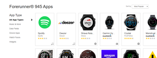

  • If you go to the app store by way of Garmin Expess, you get a view based on device, where you can filter by app type, most recent, most popular, etc
    But even though it says there are many pages, it too stops at 4 so there's a bug there too,
  • Got it, thanks! I never launch the app store from Garmin Express, so I wasn't sure how the OP was getting to that page.
    Yeah, overall I think Garmin just hasn't been maintaining the device-specific pages in the same way as the non-device-specific pages. It seems inconsistent to me that you can get those pages from Garmin Express, but not from the store front page. (I realize that the device-specific links were purposely removed from the store front page.)
