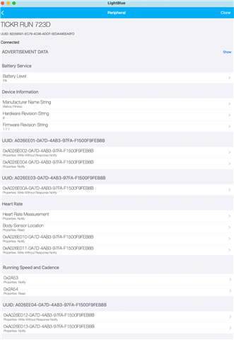

  • I would be surprized, if Garmin is actively blocking if iOS is identified anyhow. I would think, that Garmin is expecting characteristics in device information service, which is not yet sent by your iOS app, or in generic access service... maybe you should send values on all characteristics or check if there are any read requests from Garmin which are not managed in your app. By the way, what is already shown in Sensor Details on Edge?

    I'm continuing to work on this, but it displays the Device ID and "BLE", which is the same set of information that appears when I connect to a compatible BLE heart rate monitor. (I tested with a Mio LINK)

  • Thanks for your response. It is actually a native iOS app running on a different iPhone than the one paired with the 530. After trying a lot of things I am reaching the same conclusion as user 9718727 that my 530 can't connect because the device information service characteristic is indicating that this is an iOS device i.e. manufacturer = Apple. I would just like someone (hopefully a Garmin engineer) to confirm whether or not this is the case.
