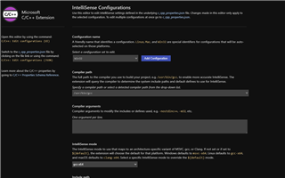

    I still think for complex multi-step tasks (including interdependent tasks like selecting min SDK version and devices), it would be nice to have a WebView that allows us to see multiple settings at once. I realize the standard UX for VS Code extensions is to have simple and (mostly) single-task oriented commands in the command palette (which is nice for things like build commands, toggles and simple selections), but I don't know if that works for everything.
    I do think Edit Application, Edit Products and Set Products by Connect IQ Version are interdependent and complex enough (with long lists) that they could benefit from being combined into a web view (along with other app properties).
    Case in point: Microsoft's C/C++ extension has a config UI page with logically grouped settings and plenty of explanatory text. It would be great to see something like this for Monkey C project settings.
