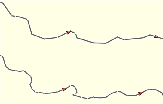

    Looking at this Garmin support article, it's implied that data is lost (IMO):
    https://support.garmin.com/en-US/?faq=xQvHXbfaT27Zr4hxZDvjv5
    "The difference between these options can be seen in the image below. The upper track represents Smart Recording while the lower track represents Every Second Recording."
    Those two tracks don't look equivalent to me.
