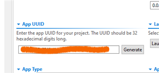

Go into the manifest editor in eclipse, and you'll see this:
Hit "generate" to get a new ID, and save the manifest. Rebuild the .iq, and you should be able to upload just fine. This is a one time thiong. You want to stay with the same manifest ID for your app.
