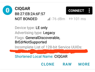

  • With the node.js code I posted, I can consistently see the pi devices from both the sim, with the nrf52-dk or the dongle, and from real devices (I use it to control my garage door all the time).
    Start with that, and see if it works.  I've not tried the gatt code you reference. Based on your version of raspberian and a pi3 vs pi4, you may need a different version of node.
    With nrfconnect on a phone, this is what I see for one of the pi devices:
