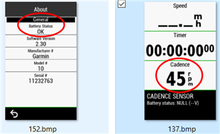

  • I have a similar problem DaveBrillhart, but with a Garmin SpeedSensor.  I can see batt status in my Edge530 device settings, but not in my app (reports null, like you).  I do, however, see battery status for my Power Meter in my app now.  I'm using the "polling method" - similar code but without the listener.  Is your cadence sensor a garmin variety?
  • Hi. Yes a Garmin sensor. I’ll update my code to scan my other devices and see if I can get battery status. Power, Speed and Cadence. Will let you know.
