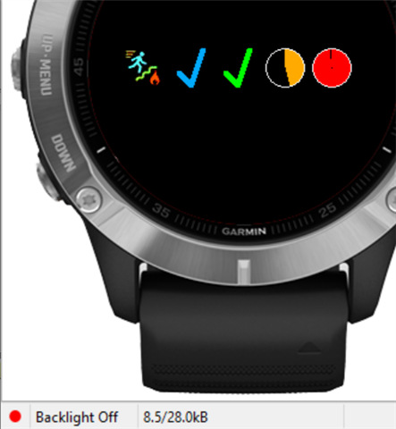

No, it does not. The real 945 just show the widget's name instead of the last picture indicating that the getGlanceView isn't called. As I said before, I had yesterday a very simple glance view online for this widget (just showing steps/stepgoal) and with this simple glance view, the real watch had no problems, it showed steps and and stepgoal as supposed to.
I haven't recoded anything else around that glance view, just the glance view itself. I added more code to show the pies you can see in the last screenshot. The glance view's memory exceeded but I can't say how much since I haven't monitored the memory of the simple glance view. Now I have 8.5 kB
