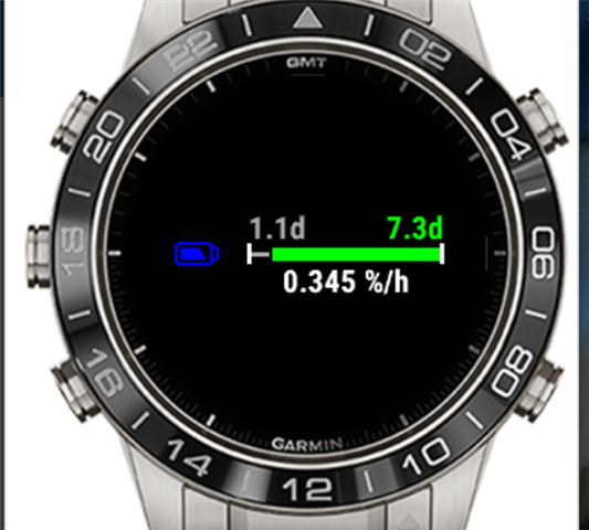

  • Hi Jim, my two posts above describe two different problems in two different widgets. Let's discuss the first, where I provided glance code but that doesn't shows up on the real watch. Here I am far away from the 32 kB limit, at least I am believe so. Where can I find that out? The simulator says for marq series it would consume about 40 kB, for fenix 6s it says 20 kB.
    What's loaded for glance in the main application? Is it similar to backgrounding?  At least getInitialView is not loaded.
    As you can review in my picture the glance view shows up at least in the simulator. I enabled that beast for the fr945 but the glance view on my watch (fr945) shows just the app name. Another owner of fr945 told me that he could see it shortly but on my request to send a picture he said  it's gone. I am really confused now.

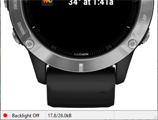

  • As far as memory that's used in the different things, for backgrounding, it;'s stuff with the (:background) annotation.  For glance view, stuff with the (:glance) annotation along with the (:background) annotation, and for the regular view, it's everything.  AppBase is always loaded (it's used for backgrounding).
    To check on memory in the sim, You'll see that at the bottom of the sim window when you're in glance view (3.1.6 SDK)
    The difference with the marq is odd....  Are you using the (:glance) annotation?  If you don't you may be loading more than you need when you're doing glances.  With the widget above, I'm at 17.8kb for all sim targets with glances.
    The full screen widget is a bit over 34kb
