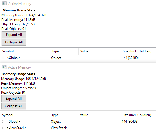

  • So I just tested and it is 12 bytes - maybe I was exaggerating Slight smile
    In the simulator I opened the memory view, then I added "var myTestVar;" to my view class, then I ran and checked the memory view again. And the difference in global size is 12 bytes - just for one uninitialized variable.
  • If you add code to copy the array, then you also have to take account of how much memory that code takes up! So it might be better or worse Slight smile
    I find myself checking the memory view, then try making a change, and then comparing the memory view afterwards to what it was before and see whether the change was a good or bad one.
