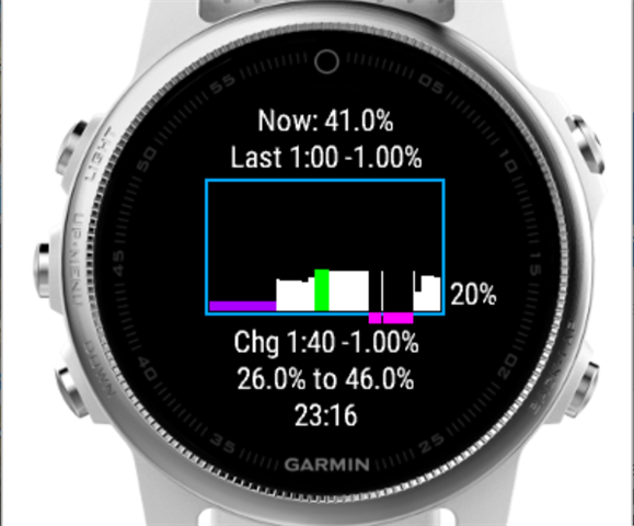

  • One thing to consider is how/when/what is useful in something linke this.  Consider the following temporal event:
        function onTemporalEvent() {
        	var old=Background.getBackgroundData();
            var newData=[Time.now().value(),Sys.getSystemStats().battery];
            if(old!=null) {
            	newData=old.add(newData);
            	var sz=newData.size();
            	if(sz>maxSize) {newData=newData.slice(1, sz);}
            } else {
            	newData=[newData];
            Background.exit(newData);
    Really simply and light.  There's an array, and the newest one is just added to what's not been seen by the widget yet, with  a "max" for how many samples.  I'm using a maxSize of 144 right now, with is one reading every 10 minutes for 24 hours.  In onBackgroundData, what it knows is combined with the new data, and is again limited to "maxSize" vales.
    So, the widget ends up with up to maxSize samples, with time stamps.  And the widget, which only runs a few times a day, can do the "heavy lifting" and display the data.  With this scheme, the widget can easily see the change in the last hour (with the timestamp), see when the last changing happened (the level increased x% from the older reading), and can see when the background didn't run because the watch was off, plugged into a PC, running a CIQ device app, etc. The time stamp again).
    So what you can show is something like:
    This is from the sim so a bit boring, but purple is the low value, green the high,the space on the graph with the pink underneath, the times the background didn't run, change over the last hour, how long ago it was charged and the change since then, etc.
